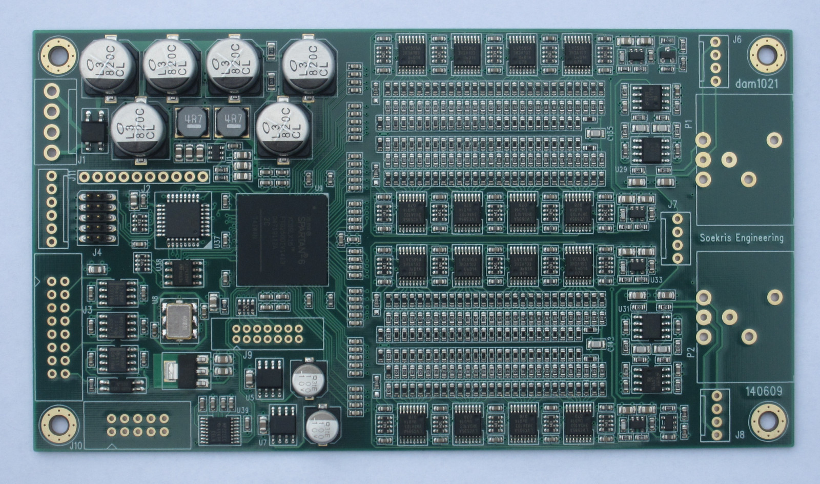

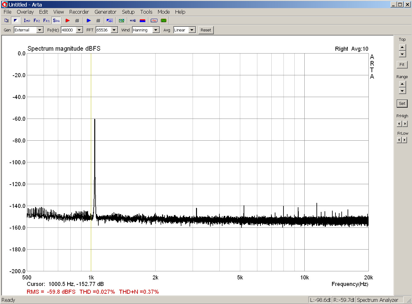

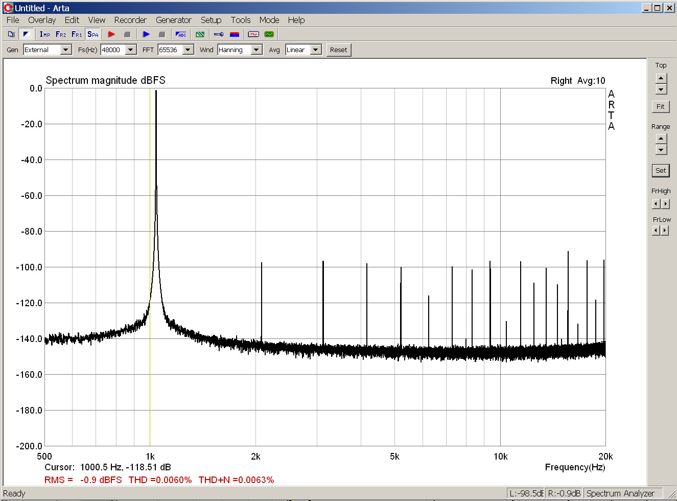

    I have been working on a little side project, now it*s time to present it for everybody here....
    It*s a DAC module based on a discrete R-2R sign magnitude DAC design, with FPGA based reclocking and custom digital filters, < 1 ps jitter clock generator, with 28 bit resolution so there is headroom, oversampling up to maybe 3.072 Mhz. Up to 24 bit / 384 Khz input from SPDIF, I2S and USB (via USB to I2S interface board), with isolation on the I2S interface. The board will be very flexible, with digital volume control and filter parameters that can be downloaded, a possibility is also to add digital crossover filters, but that will probably not be ready for first production lots, although the board is firmware upgradable over a simple serial connection.
    The basis R-2R network has an output voltage of 1.4V RMS and output impedance of 1.2 Kohm and can therefore drive a lot of things directly.... There is also onboard balanced output drivers that can drive high impedance (>= 300 ohm) headphones directly. The power supply is also onboard, just add a 5W toroid transformer.
    It is a small mostly surface mount PCB, and yes, I have working prototypes, see below.... But it*s not really something for home assembly, with the FPGA in BGA package and 600 pcs SMT parts.... So yes, if there is enough interest it will go into real production, with sales though two existing online shops in US and EU.
    Performance of first prototypes using 0.05% resistors is better than expected, see 1 Khz -1 db and -60 db FFT plots. I believe that the sound quality will be the absolute best, better than any Delta Sigma DAC, in class with discrete DAC*s from totaldac and msb technology. And for way way less cost

    Штука интересна тем, что толпа народу выстроилась в очередь за дискретным 28бит r-2r цапом, с выходом по напряжению и ключами 595.

    Ветку там читал кто ? Измерения проверяли ? Подобные ("true" r2r) конструкции хорошо если -90 дб достигают (msb к примеру), а тут сразу -100 почти Другое дело, что эти 80 90 100 дб на стационарном сигнале слабо коррелируют с качеством звучания имхо

    Во первых это не чистый R2R, а сегментированный (как и MSB), потому и -100. Иначе было бы на 2..3 десятка децибел хуже.
    Во вторых чисто из принципа, при использовании деглитчера и калибровки, на такой схемотехнике можно опуститься и до -110, и ниже (по крайней мере в небольшом интервале температур). Только для этого давным давно существую интегральные конвертеры. Причем для этих несчастных -95..100дБ хватит и 16 бит приборов.

    Там, судя по фото колинеар, 23+23 = 24 бита. 7 старших - не биты, а сегменты, т.е. это 3 старших бита.
    4 бита нижних для цифровой регулировки громкости.
    Скорее 8 нижних бит. Т.к. с ростом амплитуды сигнала пропорционально растет и шумовая полка из-за нелинейностей младших разрядов, ограничивая ДД теми же 100дБ.
