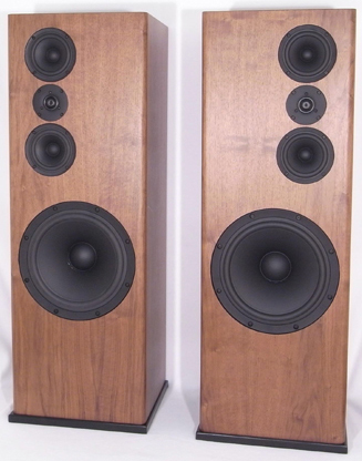

    По умолчанию Новая разработка Запха 3х полоска с 12шкой на SbAcoustics
    http://www.zaphaudio.com/SB12.3/
    INTRODUCTION
    This is a large floor standing three way system using SB Acoustics drivers. We use the SB29RDC-C000-4 ring radiator dome tweeter, affectionately known as the dimple dome. For the mids, we use a pair of SB15NRXC30-8 5" midwoofers, and finally a SB34NRX75-6 12" woofer to handle the low end. These are all drivers with very high performance at a good price, and the build quality is excellent. The midrange and tweeter are fully tested and reviewed in the comparisons elsewhere on this site, and the 12" woofer test results are posted below.
    Small designs are a dime a dozen, but very large multi-way designs are not so common. I teamed up with Madisound to "go big" in a big way and this project is the result. The world is full of tiny designs that might find their way to a small shelf, hidden between a plant and some books. This is a design for the other end of the home decor spectrum - when a visitor walks into the room, they can*t help but say "holy crap, look at those speakers!"
    There were a couple of directions we could have gone with this selection of drivers. It came down to the decision between front mount and a side mount woofer. Those two layouts require different crossovers so we had to pick one. We decided on the layout that could be described as "classic wide". These are much more than party speakers however. The design is high end throughout and I can*t even fathom how much a system like this might cost in the retail world. If I had to take a guess, I*d say somewhere in the 5 digit range. While this system is still not exactly cheap, DIY brings the cost down to be much more affordable.
    думаю стоит собирать

    По умолчанию Re: Новая разработка Запха 3х полоска с 12шкой на SbAcoustics
    Обычная АС.Ничего особенного.
    готовых проектов более чем 2х полосок на сб акустиксе мало
    цена на эти дины привлекательна.

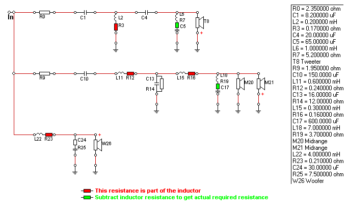

    Я бы не стал. Больше похоже на сабвуфер+d*appolito.
    С17 на середине не нравится.
    Сабвуфер + д"Апполито будет интересней чем эта конструкция ...
    в смысле SB17NRXC35-8?
    Нет, электролитический конденсатор на 600мкФ.
    cka3o4nuk, я бы не стал это чудо собирать, хотя возможно для домкино сгодиться, но все-равно дизайн ящиков уродский. А для музыки даже десятка от СБ тяжеловата.
    Я бы сказал - интересные колонки, но не для всех. Что-то типа "какими должны были быть С90". Толково, широко, но без претензий
    Вместо двенашки десятку SB поставить, корпус сделать узким, переднюю морду с закруглениями, НЧ сбоку и будет уже намного лучше.
    нч сбоку от 400гц будет играть .. как интересно - в топку.
    Есть такая проблема, от 400 это будет высоковато, возможны проблемы с мидбасом, а если опустить может появиться другая проблема с накачкой. Но если эту проблему решить то получим в результате очень хорошую локализацию источников. Подобная АС есть у моего знакомого.
    И решается эта проблема активным разделом, возвращая к дАпполито+саб...
    Сюда-бы легкий прошный мидбас, раздел на 400-500, и колоночка бы заиграла. двенашка сб - это средненький сабик...
