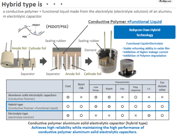

    https://www.rubycon.co.jp/en/products/pmlcap/
    Polymer Multi-Layer Capacitors (PMLCAP)
    Conductive Polymer Aluminum Solid Electrolytic Capacitor (Hybrid Type) "PZ-CAP" is a next-generation capacitor that supports high reliability uses a conductive polymer and hybrid an independently developed functional liquid as a cathode material instead of the electrolytic solution of non solid alminum electrolytic capacitor.
    It has excellent high ripple resistance and low ESR (equivalent series resistance) characteristics in the high frequency range, and is ideal for reducing the size and cost of automotive units as an electrolytic capacitor with almost no change in characteristics due to temperature. In addition, it can be widely used as a power source for industrial equipment and communication equipment.
