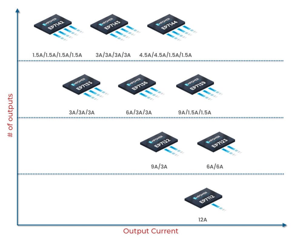

    The EP71XX Series is the industry’s highest density IVR, integrating four voltage rails in a miniature IC offering industry-leading performance and extensive fault protection without external discrete components
    https://www.empowersemi.com/3-3v-int...egulators-ivr/
