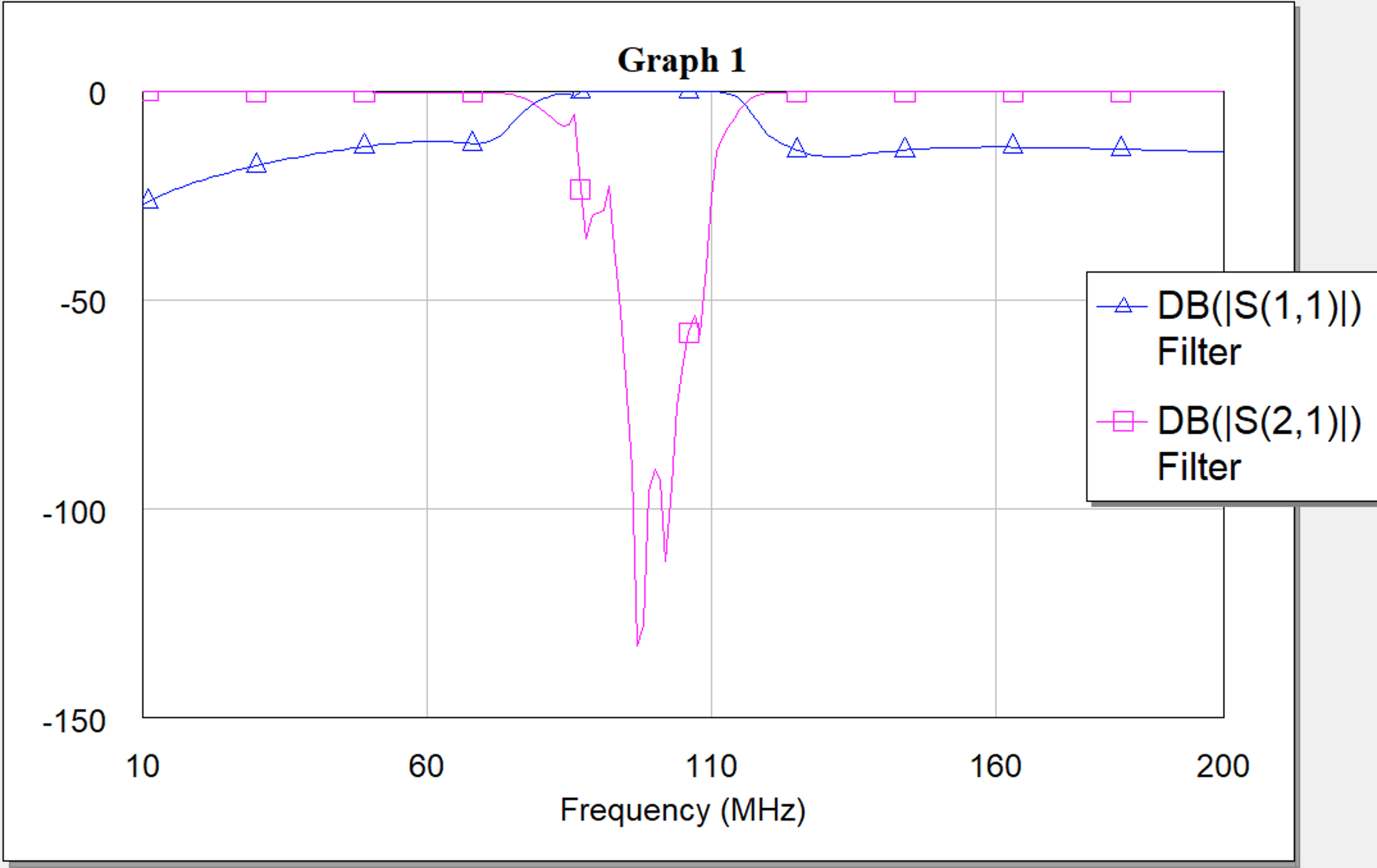

    Судя по симуляции не айс . В реале будет еще хуже
Название:	Снимок экрана 2025-05-23 в 23.53.32.png

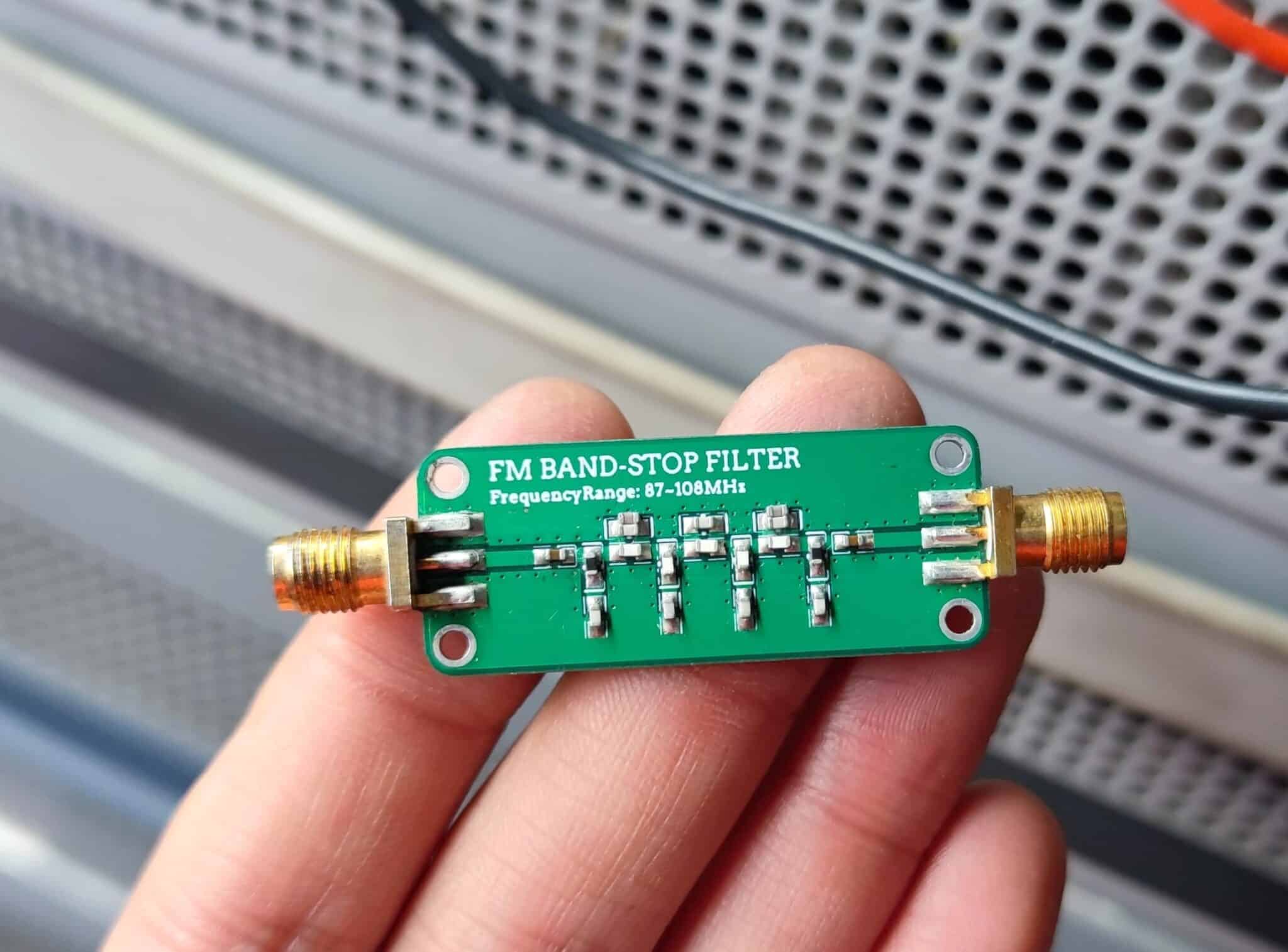

    measure the S21 parameter of the filter, divide the input connection network of the filter into port 1, and connect the output to port 2, and start the measurement
    Some people may ask, why is the insertion loss different from the simulated one, the simulated insertion loss is 0.dB, the measured interpolation loss is several dB, and the stopband frequency changes slightly?
    Obviously, simulation and reality cannot be completely consistent, simulation is the use of idealized models for simulation, and reality is subject to the parameter error and material of the component; It is a normal phenomenon that the plate and other aspects are affected.
    As can be seen from the S21 parameters, the effect of this filter is already very good.
    measured map of S21 parameters in the whole section of 9KHz~4GHz.
    The higher the frequency, the greater the insertion loss, which is also a normal phenomenon caused by the component itself
