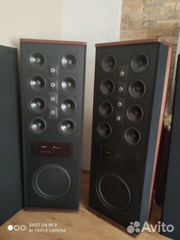

    Polk Audio SDA SRS Signature Reference System
    Recommended Amplification: 10 - 1000 watts/channel
    Efficiency: 93 dB
    Max Output level : 125 Db
    Dimensions : 165 cm – 55 cm – 33 cm
    Weight : 81.6 Kg / per cabinet
