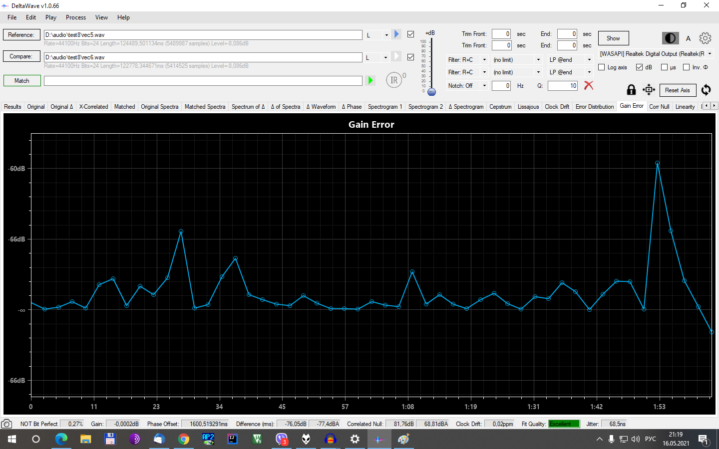

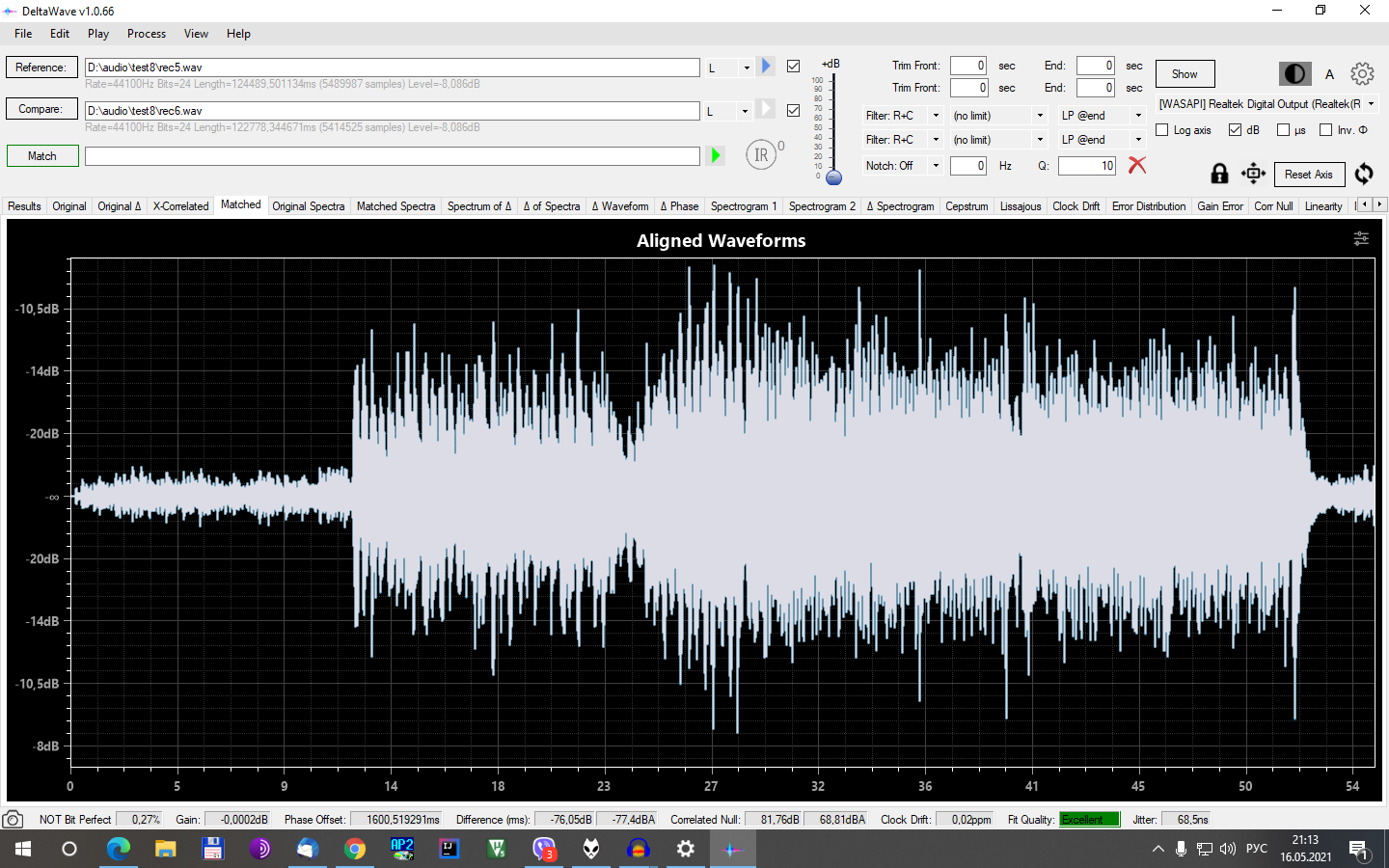

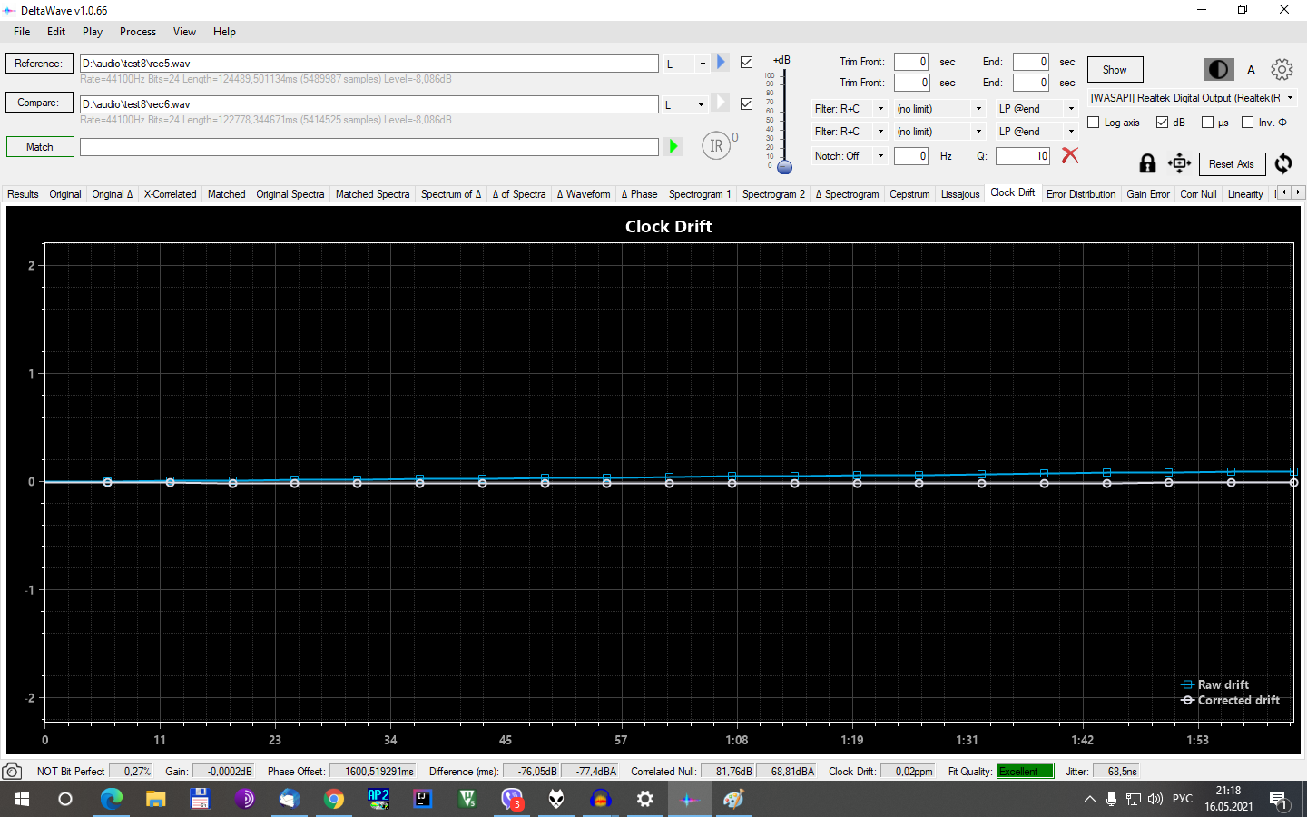

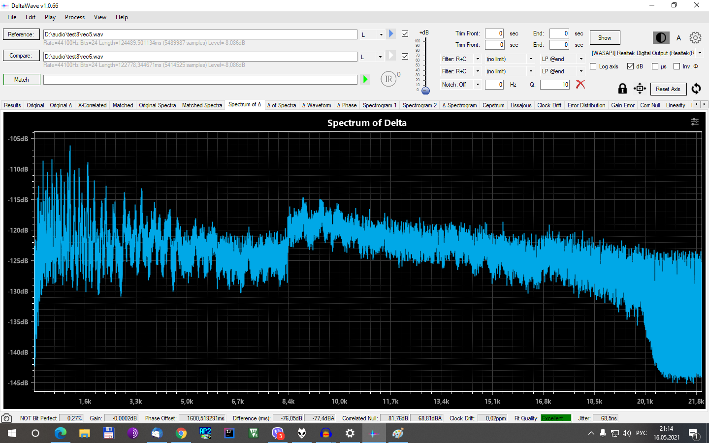

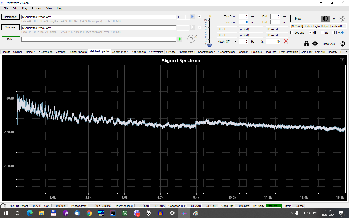

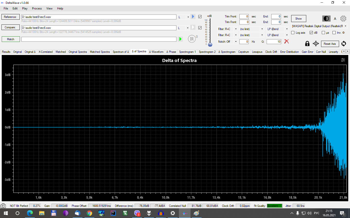

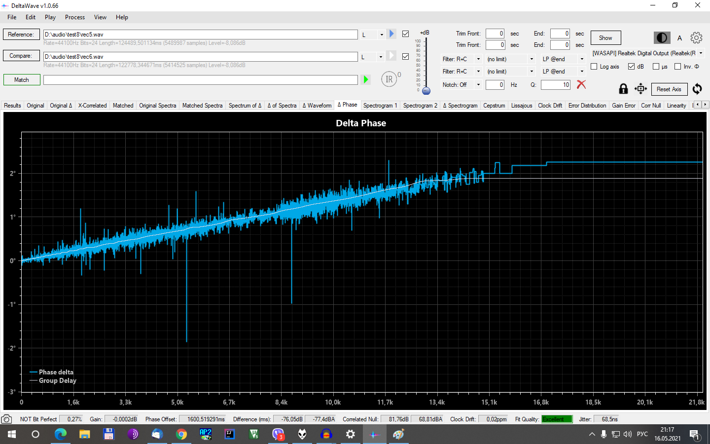

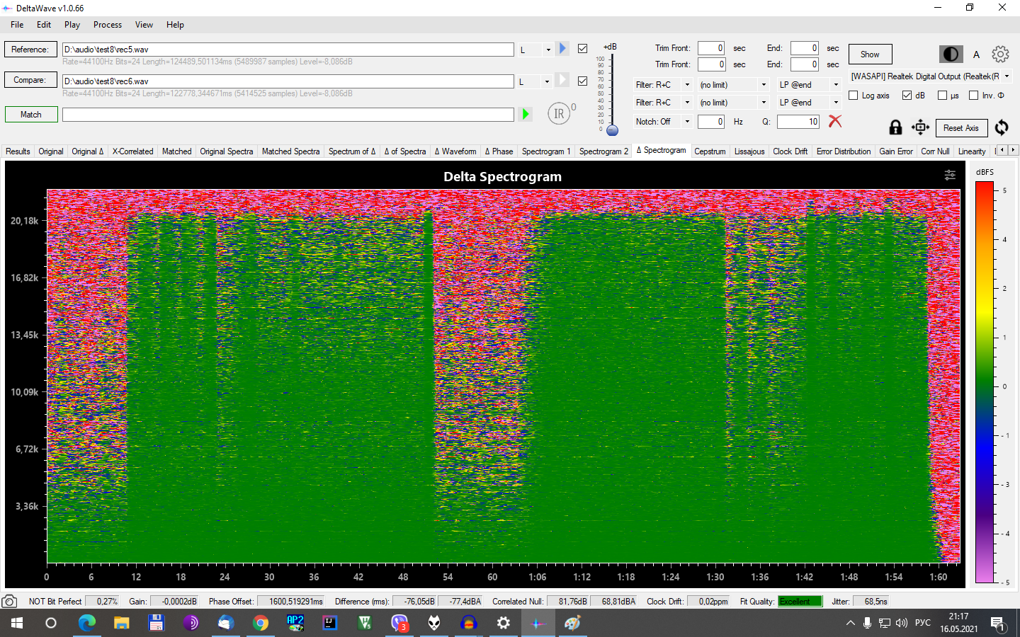

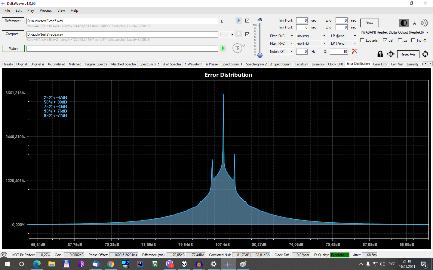

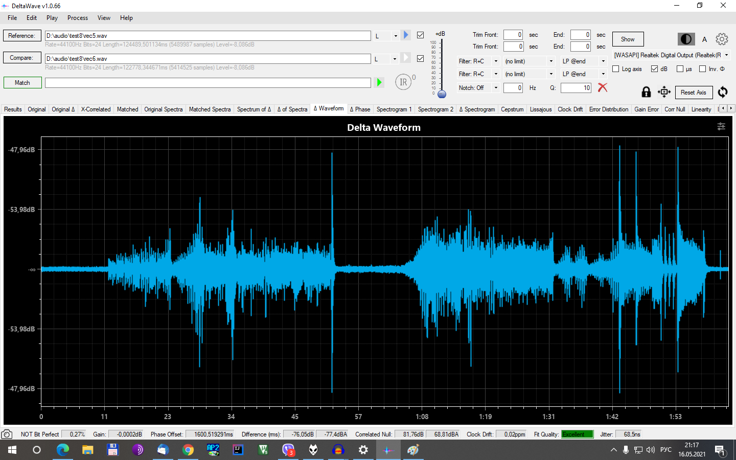

    По поводу -70 дБ с одного и того же источника.
    DeltaWave говорит так:
    Отчет
    DeltaWave v1.0.66, 2021-05-16T21:10:48.2002963+04:00
    Reference: rec5.wav[L] 5489987 samples 44100Hz 24bits, stereo, MD5=00
    Comparison: rec6.wav[L] 5414525 samples 44100Hz 24bits, stereo, MD5=00
    Settings:
    Gain:True, Remove DC:True
    Non-linear Gain EQ:False Non-linear Phase EQ: False
    EQ FFT Size:131072, EQ Frequency Cut: 0Hz - 0Hz, EQ Threshold: -160dB
    Correct Drift:True, Precision:30, Subsample Align:True
    Non-Linear drift Correction:False
    Upsample:False, Window:Hann
    Spectrum Window:Hann, Spectrum Size:131072
    Spectrogram Window:Hann, Spectrogram Size:65536, Spectrogram Steps:2048
    Dither:False
    Trim Silence:False
    Enable Simple Waveform Measurement: False
    Discarding Reference: Start=0s, End=0s
    Discarding Comparison: Start=0s, End=0s
    Initial peak values Reference: -8,086dB Comparison: -8,086dB
    Initial RMS values Reference: -25,193dB Comparison: -25,133dB
    Null Depth=7,884dB
    X-Correlation offset: 70583 samples
    Drift computation quality, #1: Excellent (0,3μs)
    Trimmed 0 samples ( 0,00ms) front, 0 samples ( 0,00ms end)
    Final peak values Reference: -8,086dB Comparison: -8,086dB
    Final RMS values Reference: -25,133dB Comparison: -25,133dB
    Gain= -0,0002dB (1x) DC=0 Phase offset=1600,519291ms (70582,901 samples)
    Difference (rms) = -76,05dB [-77,4dBA]
    Correlated Null Depth=81,76dB [68,81dBA]
    Clock drift: 0,02 ppm
    Files are NOT a bit-perfect match (match=11,08%) at 16 bits
    Files are NOT a bit-perfect match (match=0,27%) at 24 bits
    Files match @ 49,9965% when reduced to 12,94 bits
    ---- Phase difference (full bandwidth): 1,57683193590352°
    0-10kHz: 0,77°
    0-20kHz: 1,49°
    0-24kHz: 1,58°
    Timing error (rms jitter): 68,5ns
    RMS of the difference of spectra: -124,667798257627dB
    DF Metric (step=400ms, overlap=0%):
    Median=-55,5dB
    Max=0dB Min=-61dB
    1% > -60,46dB
    10% > -58,1dB
    25% > -56,91dB
    50% > -55,48dB
    75% > -53,14dB
    90% > -51,59dB
    99% > -19,8dB
    Linearity 25,5bits @ 0.5dB error
    PK Metric (step=400ms, overlap=50%):
    RMS=-101,0dBFS
    Median=-103,3
    Max=-88,5
    99%: -91,18
    75%: -101,47
    50%: -103,32
    25%: -104,26
    1%: -109,06
    gn=1,00002857380048, dc=3,61327183825659E-10, dr=1,91372505586369E-08, of=70582,9007214876
    DONE!
    Signature: 103bcd8fa6d161b38cacc9895fb7c59b
    Скрины с программы, записанные файлы

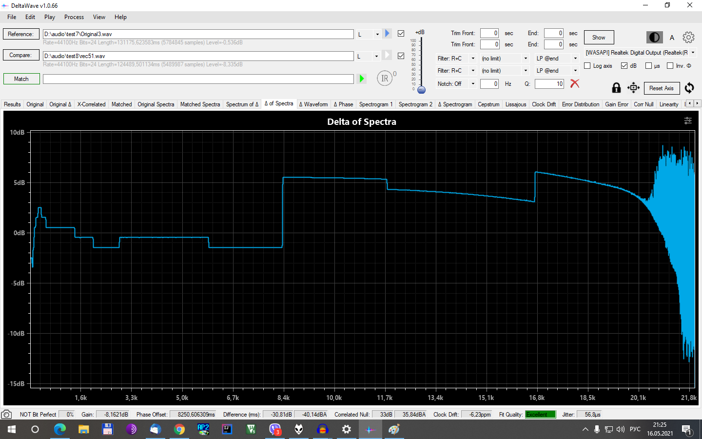

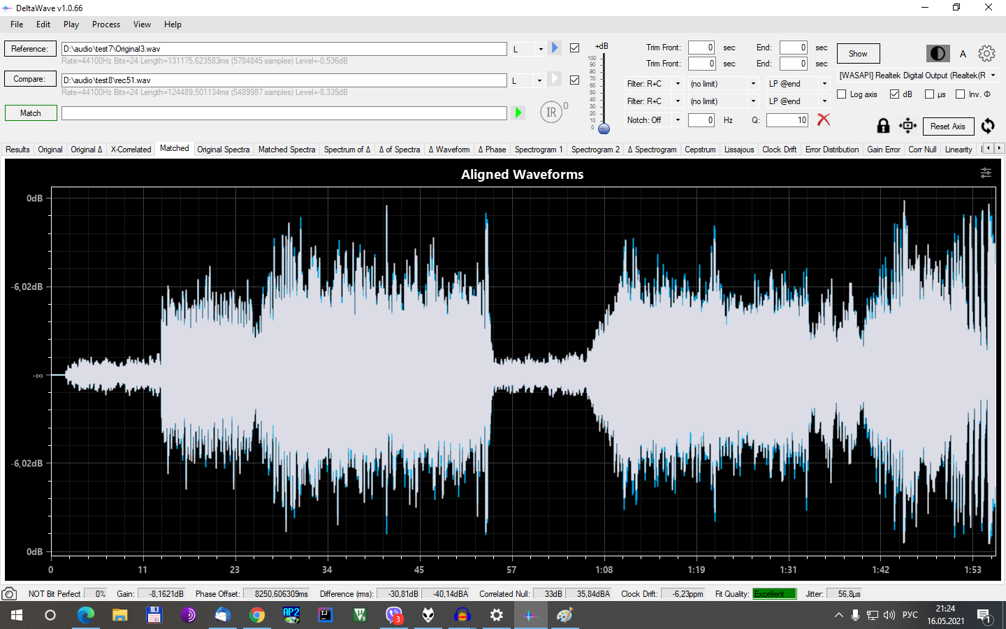

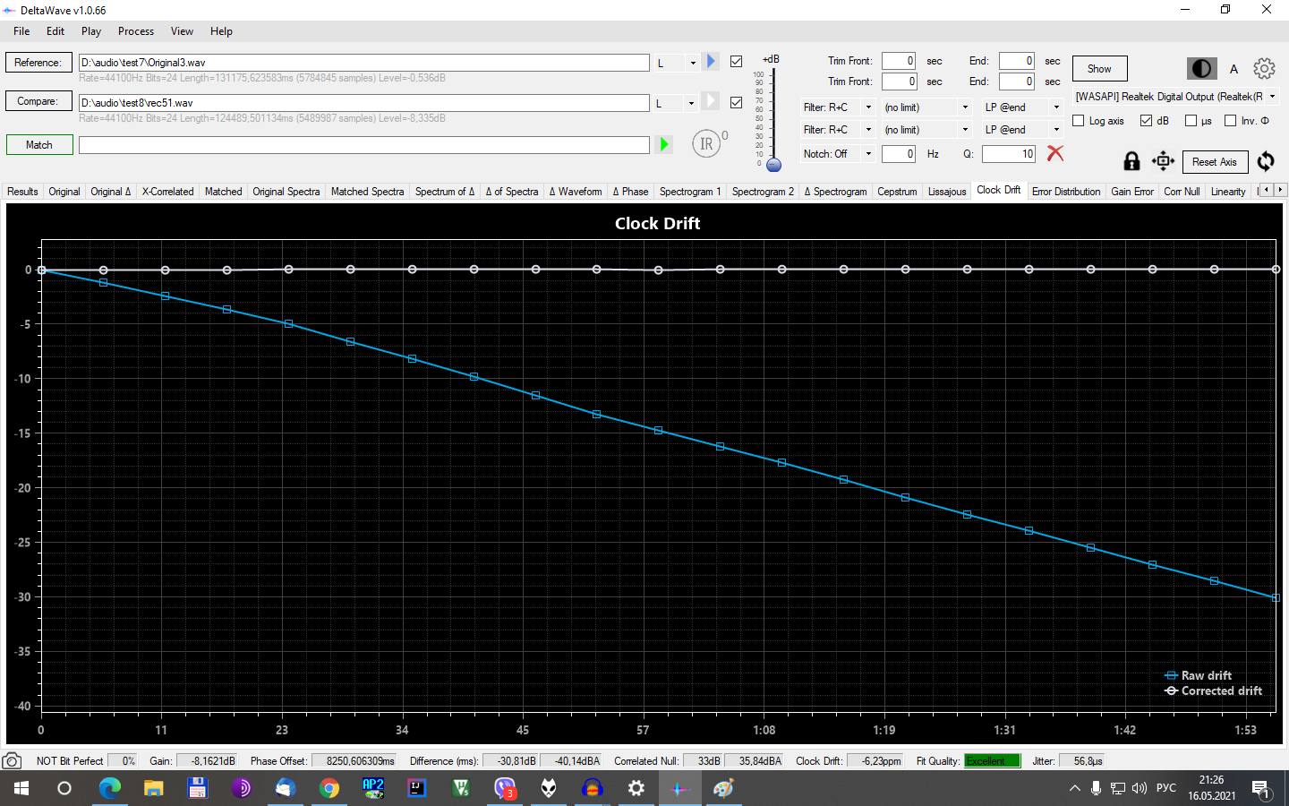

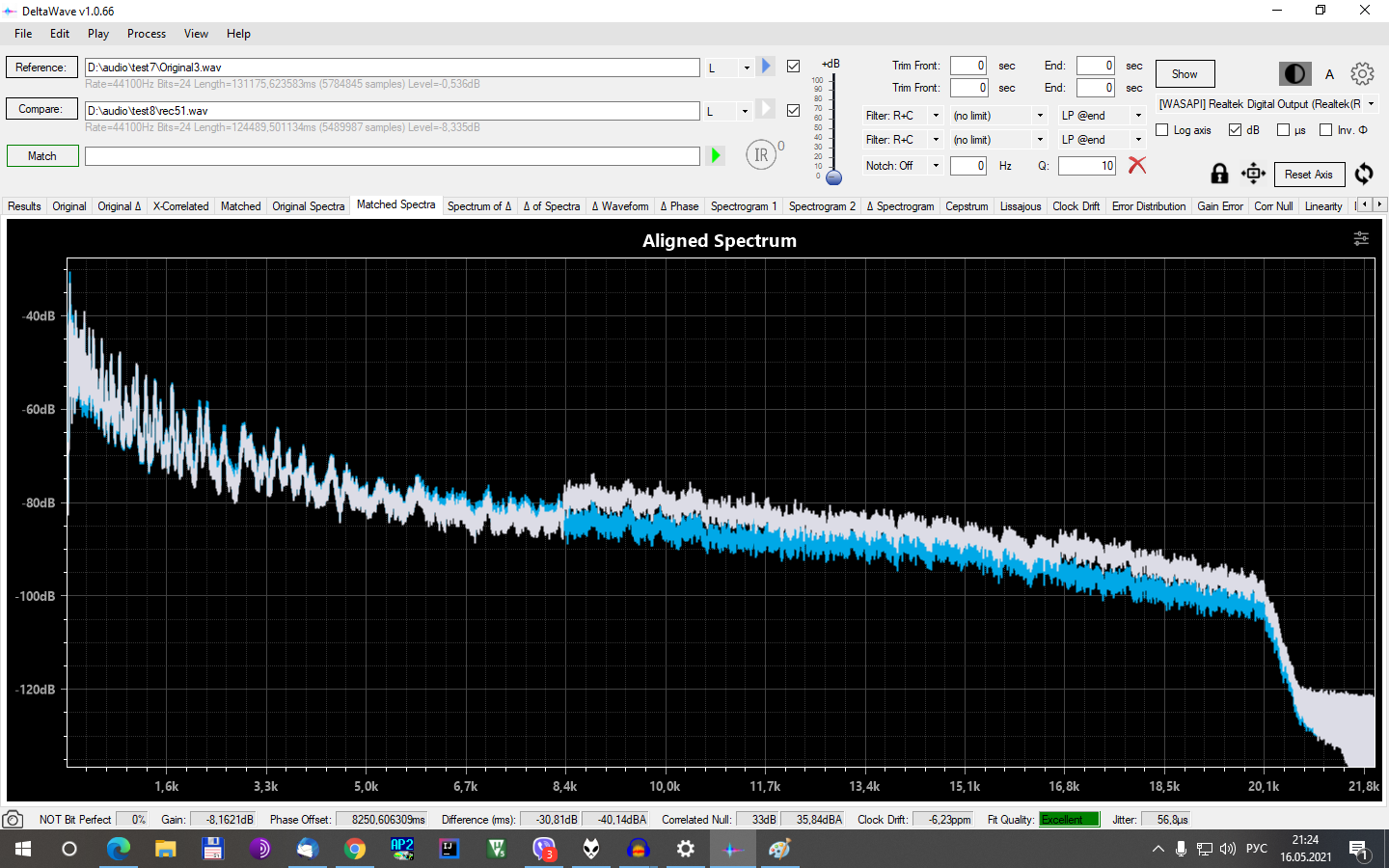

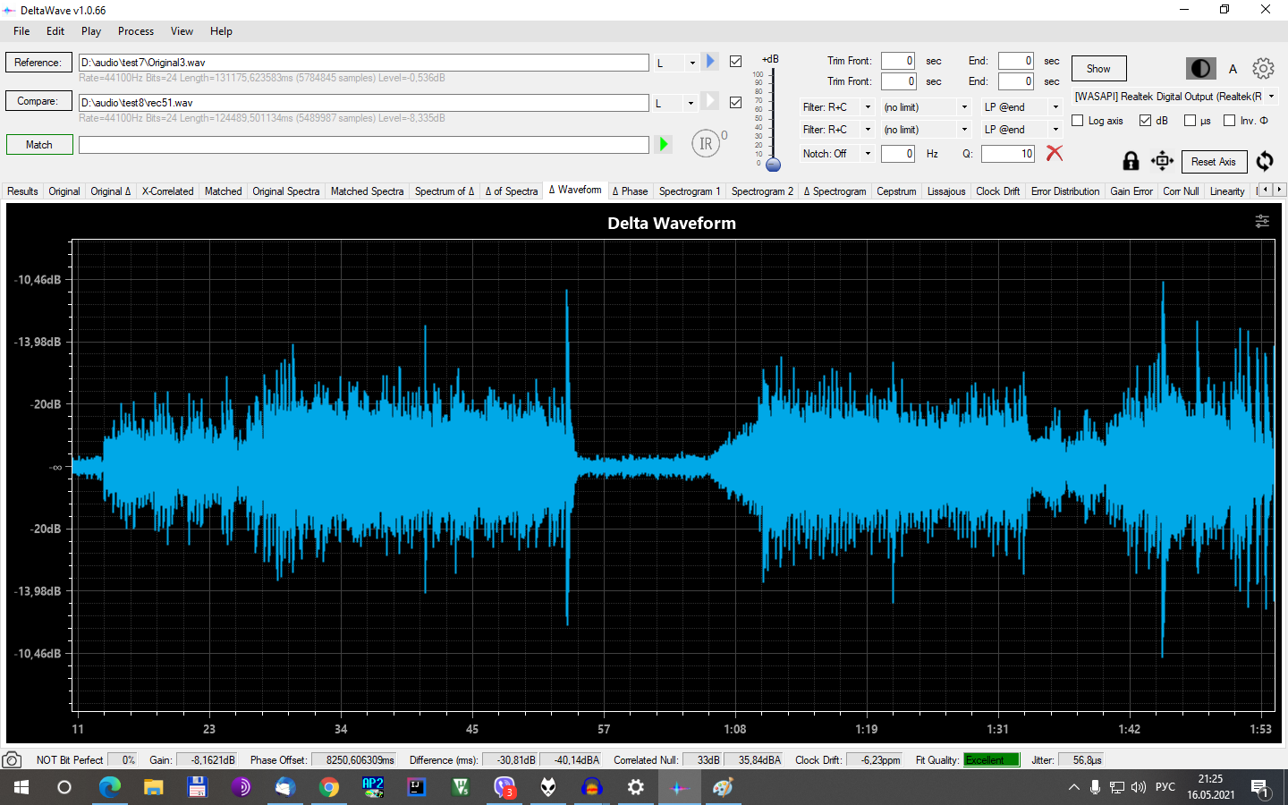

    Сравнение с оригиналом
    Отчет
    Скрытый текст
    DeltaWave v1.0.66, 2021-05-16T21:19:48.0990916+04:00
    Reference: Original3.wav[L] 5784845 samples 44100Hz 24bits, stereo, MD5=00
    Comparison: rec51.wav[L] 5489987 samples 44100Hz 24bits, stereo, MD5=00
    Settings:
    Dither:False
    Trim Silence:False
    Initial peak values Reference: -0,536dB Comparison: -8,335dB
    Initial RMS values Reference: -17,697dB Comparison: -25,852dB
    Null Depth=9,802dB
    Cross-correlation found multiple phase inversions -- data may be too noisy or too dissimilar!
    X-Correlation offset: -1371 samples
    Drift computation quality, #1: Excellent (0,33μs)
    Final peak values Reference: -0,536dB Comparison: -0,104dB
    Final RMS values Reference: -17,602dB Comparison: -17,796dB
    Gain= -8,1621dB (0,3907x) DC=0 Phase offset=8250,606309ms (363851,738 samples)
    Difference (rms) = -30,81dB [-40,14dBA]
    Correlated Null Depth=33dB [35,84dBA]
    Clock drift: -6,23 ppm
    Files are NOT a bit-perfect match (match=0,05%) at 16 bits
    Files are NOT a bit-perfect match (match=0%) at 24 bits
    Files match @ 49,9958% when reduced to 5,12 bits
    ---- Phase difference (full bandwidth): 15,1696007016249°
    0-10kHz: 21,20°
    0-20kHz: 15,85°
    0-24kHz: 15,17°
    Timing error (rms jitter): 56,8μs
    RMS of the difference of spectra: -96,8442253771157dB
    Median=-16,6dB
    Max=-13,8dB Min=-22,9dB
    1% > -22,04dB
    10% > -20,31dB
    25% > -18,74dB
    50% > -16,58dB
    75% > -16,2dB
    90% > -15,96dB
    99% > -14,9dB
    Linearity 2,1bits @ 0.5dB error
    RMS=-31,4dBFS
    Median=-31,4
    Max=-24,9
    99%: -26,47
    75%: -30,12
    50%: -31,39
    25%: -34,25
    1%: -81,44
    gn=2,55921706103312, dc=0, dr=-6,23453425348327E-06, of=363851,738242775
    DONE!
    Signature: 0c0cc5ef029af19cf6594d719a8c69df
    Честно говоря, резульат сравнения с оригиналом вгоняет в меня в ступор. ИМХО: пока мысли о неидеальности ЦФ ЦАПа. Надо опять собрать макет на CS4398 и попробовать прогнать на нём, а так же полностью цифровую петлю из 2х транспортов.

    Цитата Сообщение от Nabludatel Посмотреть сообщение
    На ВЧ сдвиг фазы ещё от применённых ОУ может зависеть.
    Наверное когда-то так и было. Но сейчас добавку там обнаружить практически малореально.
    Не совсем понятно ...каким образом обычная RC-цепь (ФВЧ), например, на входе канала записи сумеет создать одинаковую задержку во всём диапазоне частот.
    Не во всем, а толька на частотах заметно ниже частоты среза фильтра. Но прифильтрах на 100+ кГц это уже близко к тому. И нетрудно сделать и именно так.
    Не совсем понятно, что такое нормальный случай
    Это когда конструктор ЦАП позаботился от стабильности ГВЗ в аудио-полосе. Вот человек тему завел в соответствующем разделе, там можно посмотреть картинки.
    Вот это пока вызывает больше всего вопросов
    Бред какой-то получается
    А не могло быть так, что в софте какая-то эквализация или не выключилась, или включена по умолчанию?
    Не знаю, как с дельтой, с диффмейкером я на всякий случай в редакторе подгонял размер фалов, чтоб он был идентичным. Хотя конечно влиять это не должно.
    Последний раз редактировалось ViktKors; 17.05.2021 в 00:11.

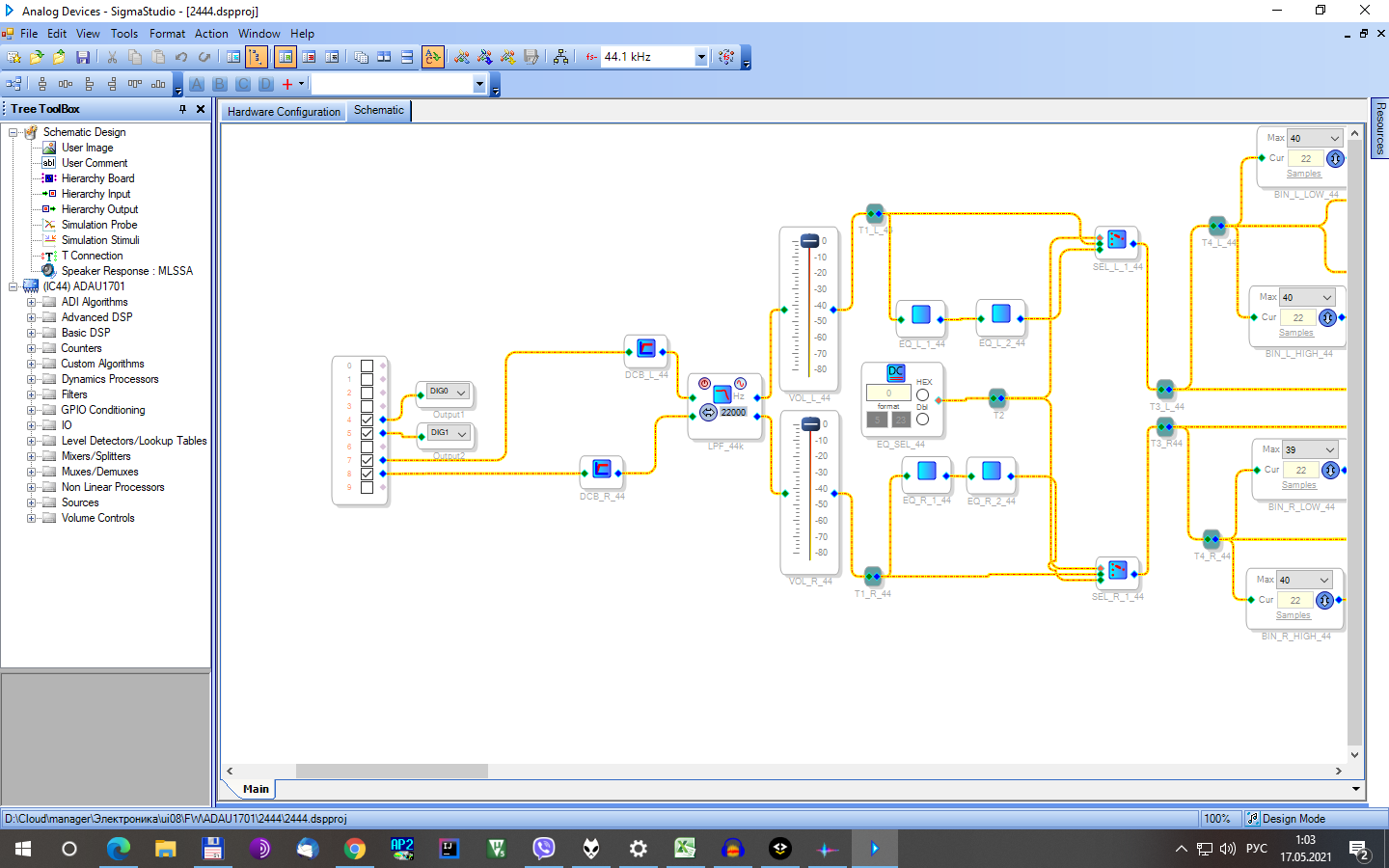

    Проект в адау: со входа сразу на выход
    вполне возможно у 1701 недостаточно ресурсов, т.к. занято почти всё в проекте.

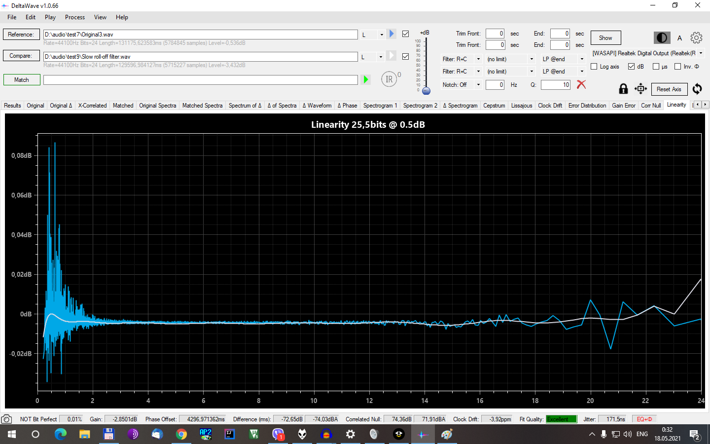

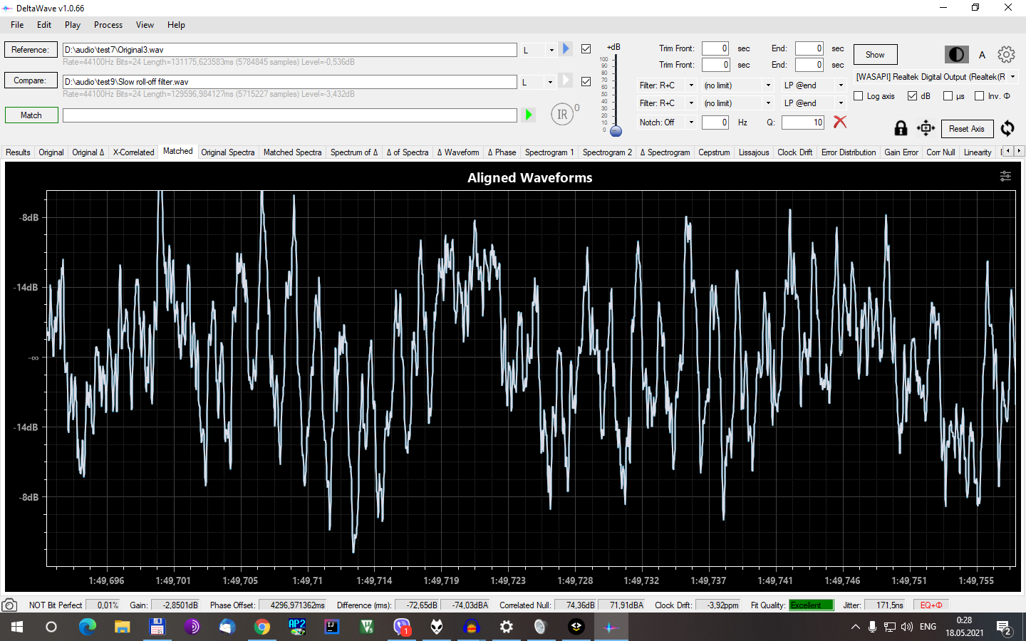

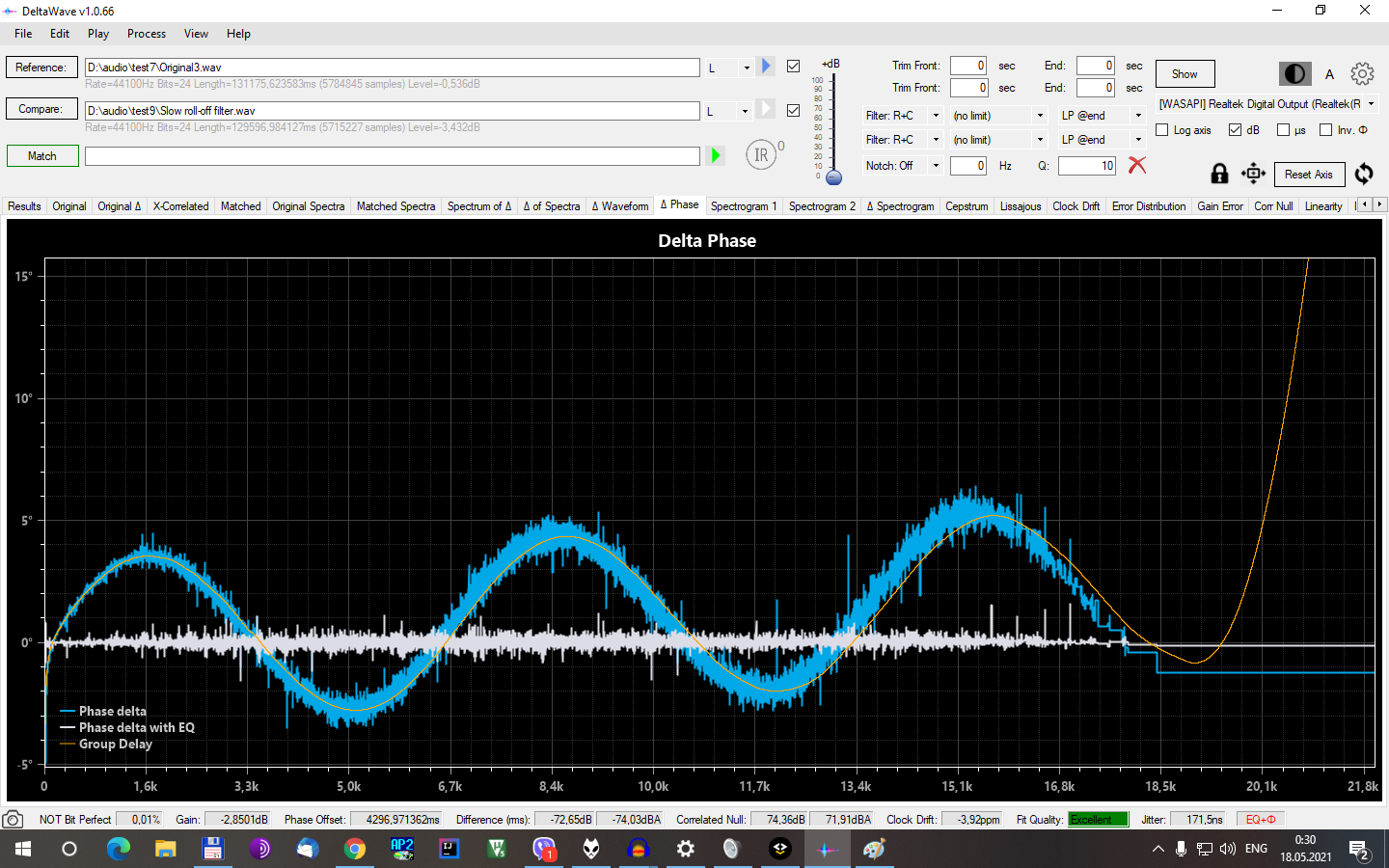

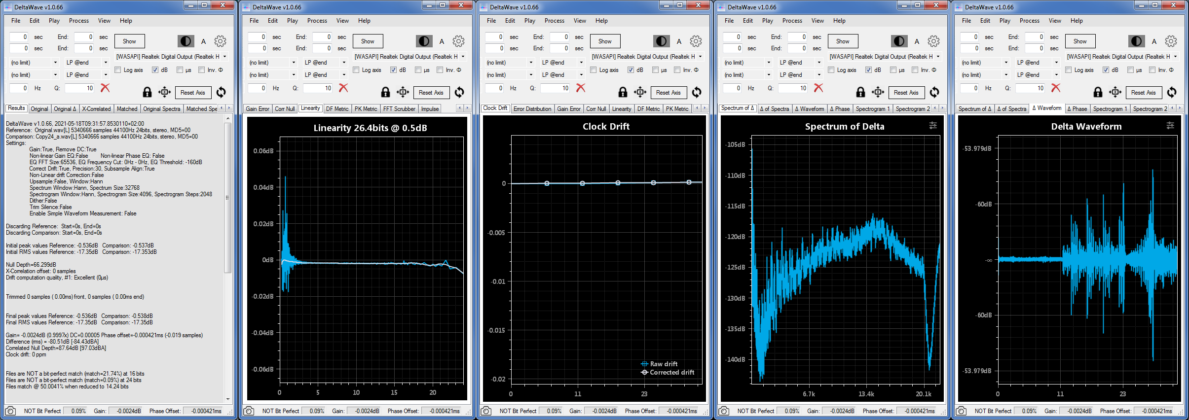

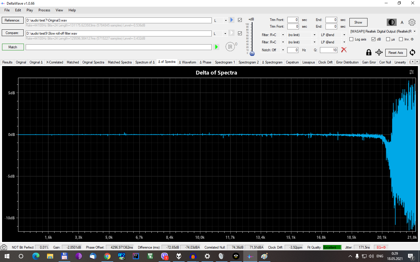

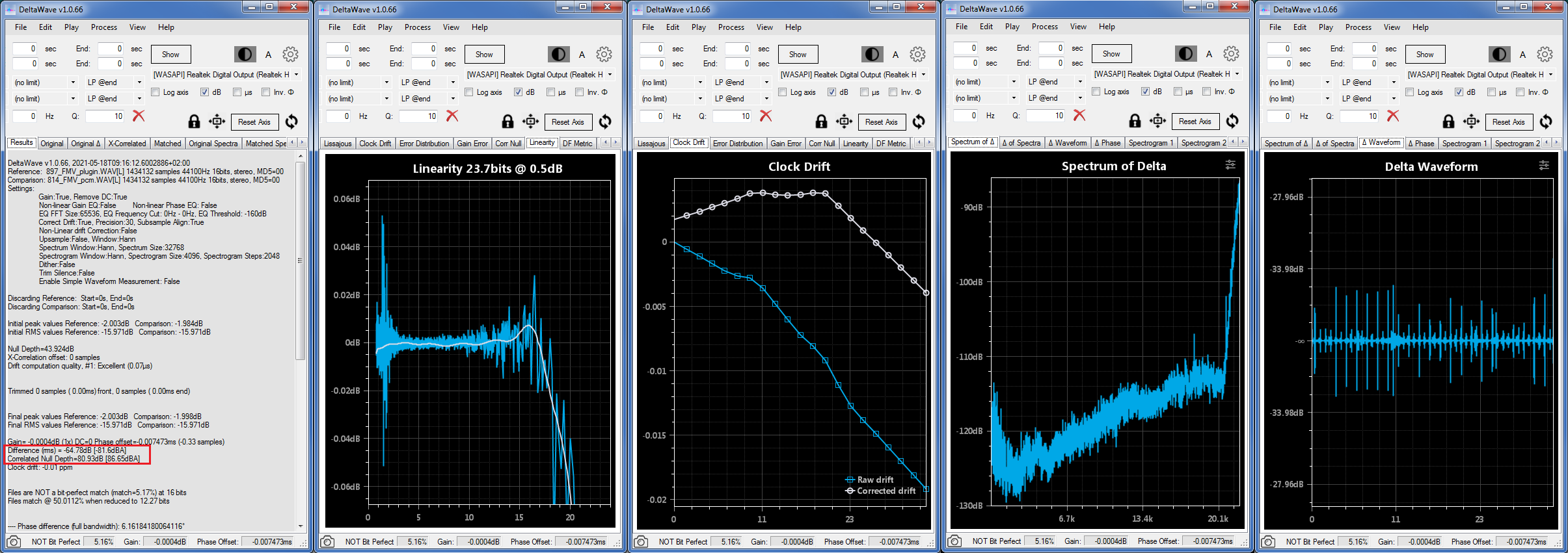

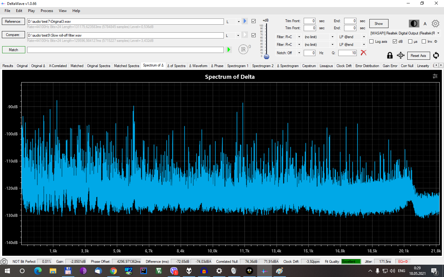

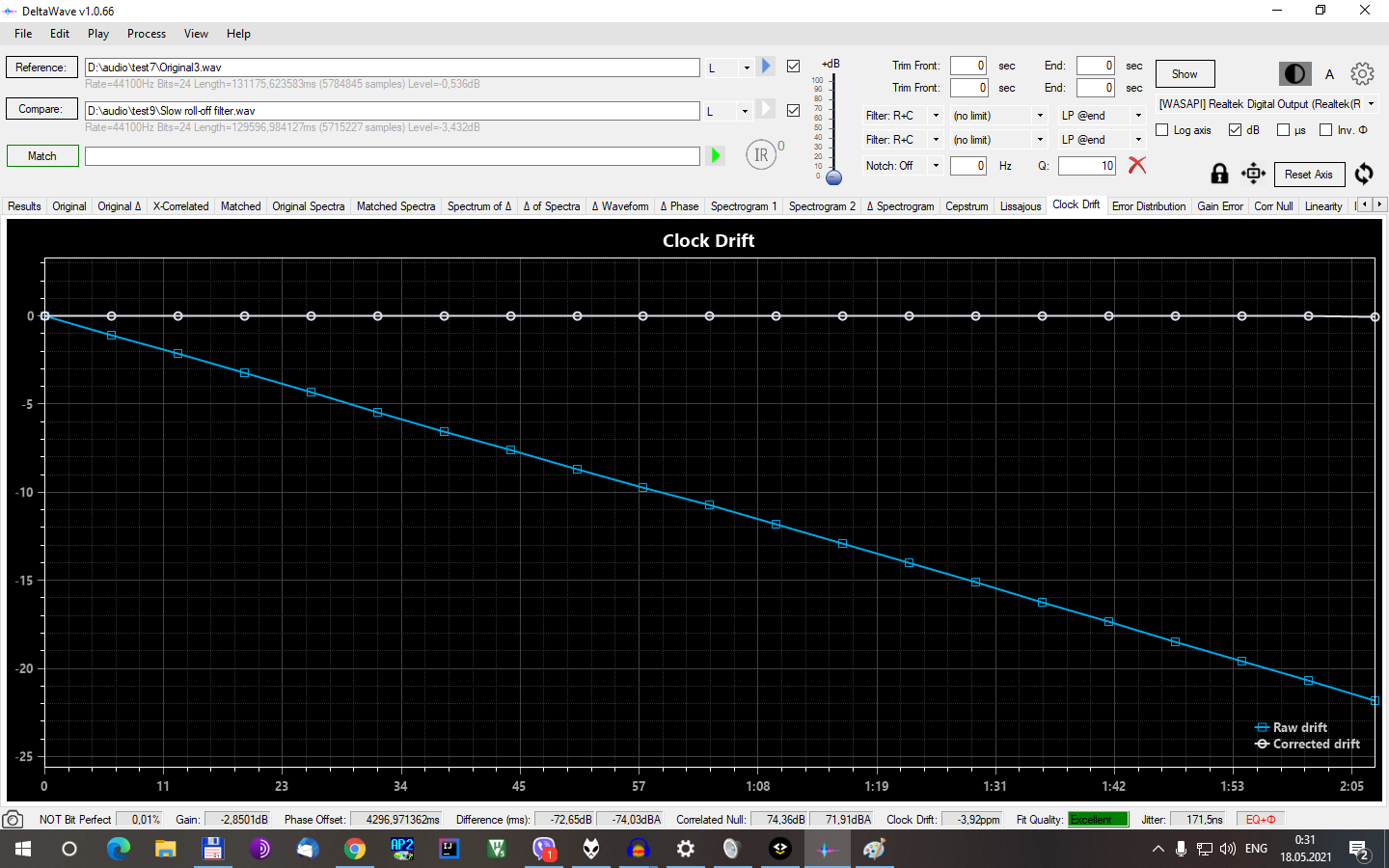

    Добился хорошего результата. Проблема со скачками АЧХ на деле оказалась включенным эквалайзером (спасибо ViktKors за подсказку), после сброса всех настроек, всё стало ровным.
    Итог: в зависимости от выбранного ЦФ результат -65...-72 дБ для фильтров Slow, ~ -50дБ для Sharp. ЦАП АК4490. Дальше выжимать будет проблематично, нужно делать единый мастерклок и похоже делать какой-то изолированный бокс, т.к. сильно лезет 50 Гц (как вариант моно запись). Пришлось немного изменить Ку буфера АЦП для более близкой подгонке к полной шкале и закоротить входные конденсаторы. Думаю есть смысл попробовать сделать кабель с конденсаторами в разъеме, а не на плате АЦП.
    DeltaWave показывает линейность в 25 бит, скорее всего лимит АЦП, для даков АК449х нужен АЦП солиднее, вроде АК5572.
    Отчет Delta Wave для фильтра Slow roll-off
    Result
    DeltaWave v1.0.66, 2021-05-17T21:57:27.6768801+04:00
    Comparison: Slow roll-off filter.wav[L] 5715227 samples 44100Hz 24bits, stereo, MD5=00
    Settings:
    Non-linear Gain EQ:True Non-linear Phase EQ: True
    Dither:False
    Trim Silence:False
    Initial peak values Reference: -0,536dB Comparison: -3,432dB
    Initial RMS values Reference: -17,697dB Comparison: -20,495dB
    Null Depth=12,098dB
    X-Correlation offset: 189495 samples
    Drift computation quality, #1: Excellent (0,18μs)
    Final peak values Reference: -0,536dB Comparison: -0,518dB
    Final RMS values Reference: -17,552dB Comparison: -17,552dB
    Gain= -2,8501dB (0,7203x) DC=0,00001 Phase offset=4296,971362ms (189496,437 samples)
    Difference (rms) = -72,65dB [-74,03dBA]
    Correlated Null Depth=74,36dB [71,91dBA]
    Clock drift: -3,92 ppm
    Files are NOT a bit-perfect match (match=4,18%) at 16 bits
    Files are NOT a bit-perfect match (match=0,02%) at 24 bits
    Files match @ 50,0043% when reduced to 11,93 bits
    ---- Phase difference (full bandwidth): 0,120370656851251°
    0-10kHz: 0,11°
    0-20kHz: 0,12°
    0-24kHz: 0,12°
    ---- Variable Group Delay. Frequency matched from 0Hz to 21,1kHz:
    1kHz = не числоsec (не число°)
    2kHz = 3,1μs (2,22°)
    4kHz = 760,6ns (1,10°)
    8kHz = 119,3ns (0,34°)
    16kHz = 52,1ns (0,30°)
    Timing error (rms jitter): 171,5ns
    RMS of the difference of spectra: -123,7543173124dB
    Median=-57,9dB
    Max=-31,4dB Min=-64,6dB
    1% > -63,57dB
    10% > -61,9dB
    25% > -60,17dB
    50% > -57,94dB
    75% > -54,67dB
    90% > -51,92dB
    99% > -37,27dB
    RMS=-80,7dBFS
    Median=-81,8
    Max=-70,8
    99%: -73,87
    75%: -79,78
    50%: -81,79
    25%: -83,67
    1%: -94,34
    gn=1,38836665745959, dc=1,29861796106728E-05, dr=-3,91997812289918E-06, of=189496,43704744
    DONE!
    Signature: a080e4fc132e1b11d86b4779e7c48083
    Файлы для теста: по ссылке ViktKors и 24/48 на скорую руку нашел в коллекции саундтрек из Horizon Zero Dawn.
    https://cloud.mail.ru/public/4EhU/5sBaFnxtd
    Получается так, что мой setup переплюнул довольно хорошие пром девайсы вроде Lynx Hilo и Aurora (-59дБ)?
    Не очень хорошо для sharp, но видимо это из-за большого разброса клоков и, как следствие, недокомпенсированой ошибки возле Fs/2.
    Линейность часто упирается в погрешность из-за шума. У меня на картинке как оно выглядит на режиме АЦП, когда я писал с уровнем под 16 Бит, аналогично с повышенным уровне показывает более 26 Бит.
    Круто "Дельта" выправила колебания фазы. Вообще актуальная версия выглядит продвинутее той, что была год назад.
    Странно "мохнатым" выглядит спектр дельты. Может это тоже какой-то артефакт забегов клока/коррекции.
    Вообще, непонятно, насколько эти эквализации хорошо работают, я вот попробовал на файлах из последней серии в "коммутаторской" ветки, получалось примерно одно и то-же, что с коррекцией, что без (это "типа острый длинный" фильтр, и несинхронные клоки)
    Но конечно на синхронных клоках все работает сильно лучше (это на файле из зарубежной ветки):

    Думаю на этом остановиться. Эпопея с текущей платой АЦП продлилась примерно 1.5 года, а общее время с момента "задумки и реальных боевых действий" больше 3х лет.
    Как появятся процессоры в продаже, сделаю версию с кое какими исправлениями и доп платой на входе с релюшками для коммутации конденсаторов и делителя. В целом я остался доволен проделанной работой, задуманный результат получен.
    Про именно "линейность" не скажу, а вот про число видимых бит (т.к на кторые чип реагирует), тут: https://forum.vegalab.ru/showthread....=1#post2896797 (и через одно сообщение после этого).

    Если соответствие входного сигнала оцифровке - так все в 20 бит сигнал/шум (причем шум тепловой) и упрется.
    А если способность рассмотреть сигнал на фоне шума - 24 Бита АЦП за счет дизеринга все равно работает гораздо ниже 24-битной границы.
    Уж по -160 - -170 дБ АЦП пики может показывать вполне адекватно входному сигналу (это проверяется простым подмешиванием сигнала малого уровня).
    Правда не без оговорок. Наблюдал как пики пропадают при снижении сигнала ниже определенного порога, так что проверка имеет смысл.
