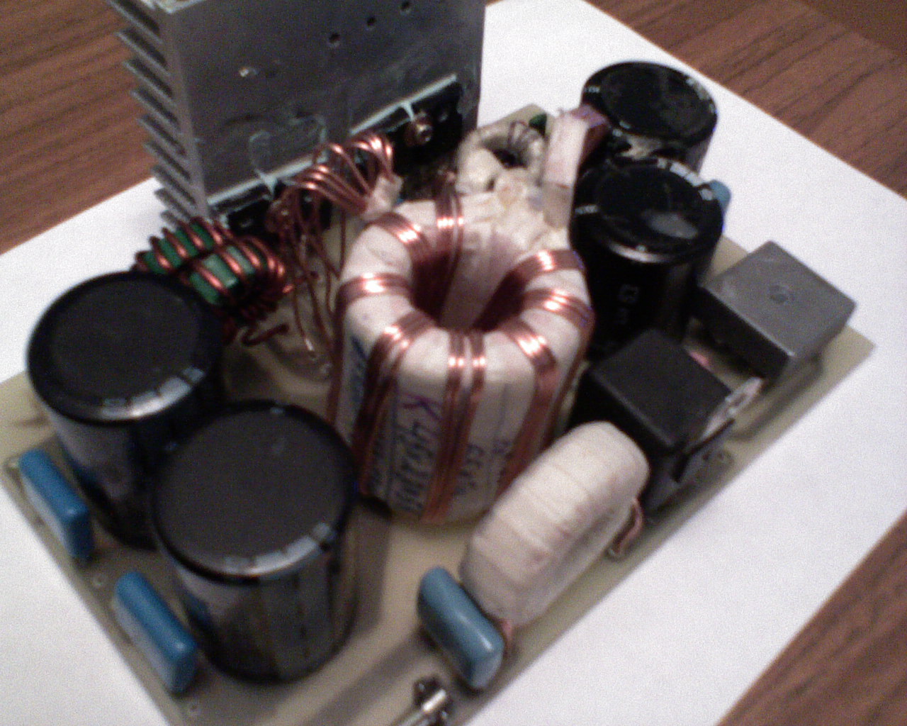

    Hello everybody. I have recently implemented the schematic designed by korolkov24, the 900w version. I have powered it with +/- 35v (with modifications for powering LM311 and IR2110), with a low-pass filter composed of L=65uH and C=1uF. Close to clipping the output looks like this:
    What can I do to fix this? Also, I have no snubbers on the final mosfets.
    schematic http://img593.imageshack.us/img593/5668/900w.jpg

    give foto of PCB that U made...
