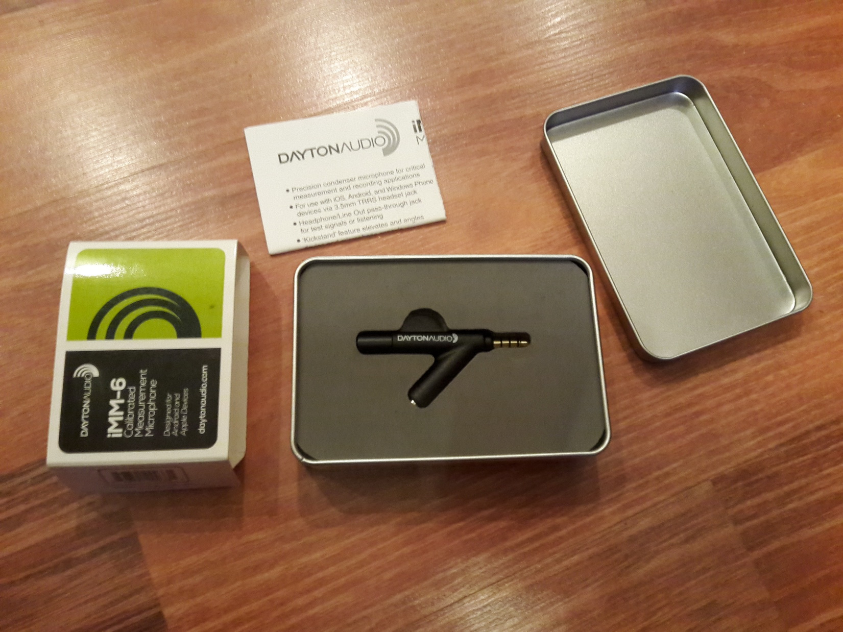

    В итоге 16.03.2017 микрофон у меня. Пока не понял как импортировать калибровочный файл. Менял расширение файла и кидал в папку программы но файл программа LoudSpeaker LAB 3.1 не видит.
    17.03.2017 фаил импортирован в ARTA! Ура!
    17.03.2017 но уже поздно вечером фаил импортирован и в LspLAB 3.1

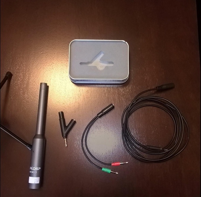

    Если кому надо будет то вот схема что бы микрофон работал с компа... спаять самому быстрее чем ждать с Китая.
ID:	290380 Нажмите на изображение для увеличения.
    Как это всё выглядит. Спаянный переходник trs на trrs и удлинитель)))

    "Accuracy of Dayton Audio iMM-6 vs MiniDSP UMIK-1
    I bought this a couple of years ago for a car audio project and was curious to see how this little guy matched up to the well regarded MiniDSP UMIK-1 USB microphone. I tested both mics nearfield on a horn loaded MarkAudio CHR-70.3. I imported the provided calibration curves into REW and adjusted the mics so that they both recorded at the same SPL. I took a few sweeps for consistency and was very surprised by the results. On the graph, red=iMM-6 and blue=UMIK-1. Both mics performed at about +-1 db difference of each other up to about 17kHZ. Pretty impressive!
    There are a few small drawbacks for the iMM-6, namely it is not calibrated for SPL measuring (unlike the UMIK-1), cheaper construction, and its smaller diaphragm means it will clip/distort at high volume levels compared to higher end microphones. However, for $20, you get a pretty capable tool and it has proved a good reference for setting up my systems.
    The only thing that really disappointed me was not with the microphone but rather the mobile software. I bought supposedly one of the best mobile apps for measurement (AudioTools by Studio Six) but didn’t find it very useful since there was no way to export data from the phone to Excel to further analyze it. I didn’t find much use for that app beyond white noise testing. REW or AudioNet CARMA for PC are much more powerful tools and if you can, I would recommend using this mic with a device that can run these programs. FYI though, it connects using a standard smartphone TRRS Jack and won’t connect to older computer mic inputs unless you have a TRRS to TRS splitter (bought mine at Radioshack). Also, I recommend a TRRS extension cable to isolate the mic and take more consistent measurements.
    Lastly, there are several reviewers on here that have bought this for recording and were disappointed, and I can confidently confirm that this is not good for that purpose. Its a measurement tool and should only be used as such. Look into buying a Tascam recorder or similar microphone if you need voice or instrument recording capabilities."

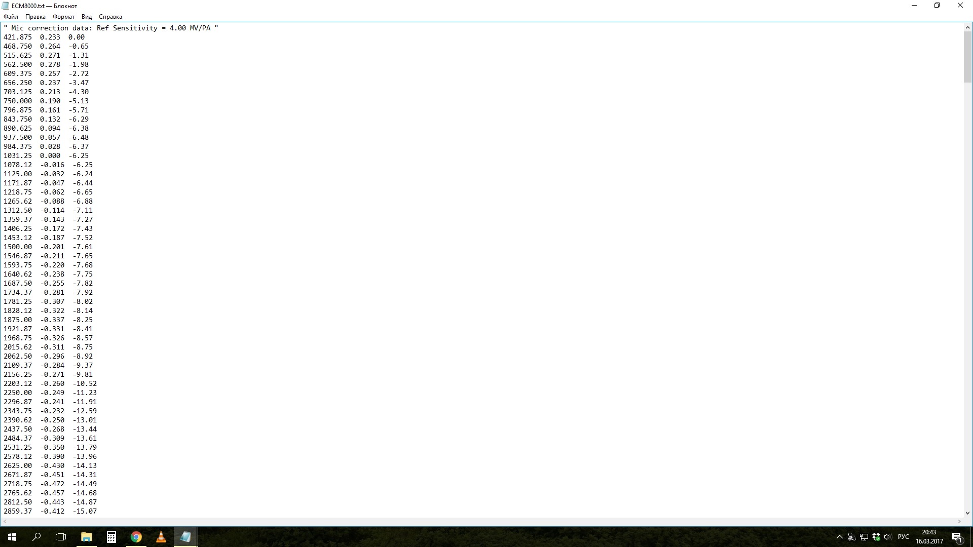

    Купил микрофон. Пока не понимаю как импортировать в прогу LoudSpeaker LAB файл калибровки. Прога его не видит. Расширение менял на DAT как надо но нифига. Вот что внутри файла.
ID:	289341 Нажмите на изображение для увеличения.
    Тот файл где в строку написан файл Dayton а тот что в столбик расписан был в проге изначально от микрофона ECM8000

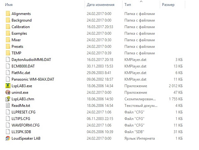

    Дат это не то. Посмотрите в программе какое расширение ей нужно. Может mic ?
    Аватар для voodoopeople
    01.06.2013
    456
    По умолчанию Re: Не дорогой микрофон Dayton Audio iMM-6. Все за и против?
    Покопаюсь по папкам поищу mic. Может я что то путаю...
    ---------- Сообщение добавлено 23:55 ---------- Предыдущее сообщение было 23:51 ----------
    Mic не нашёл. Вот как выглядит папка программы
    Если копировать работающий файл DAT который изначально был в программе и поменять ему имя то в программе он потом определяется. Видимо всё таки нужен файл с расширением .dat но он какой то ни такой.
    ---------- Сообщение добавлено 17.03.2017 в 00:04 ---------- Предыдущее сообщение было 16.03.2017 в 23:55 ----------
    Может дело в кодировке txt?
    Какая должна быть?

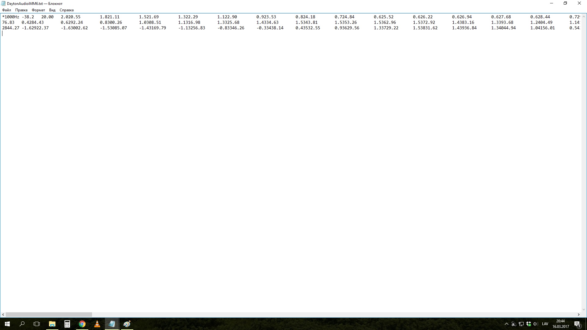

    Я калибровочный файл прекрасно вставил в коррекцию АRTA. С Лспилаб я не работал.
    Посмотрите есть ли отличия в подписях над текстом с данными. Переведите dat файл программы в txt и сравните.
    А в каком виде вы скачали файл с сайта? В txt?

    По моему текст в файле должен выглядеть столбцом. Что то неправильно с форматированием текста.
    Могу поробовать на выходных посмотреть. Напишите номер вашего мика и ссылку на страницу сайта, пож-ста.
    Где мой файл коррекции я уже не помню, проще скачать.

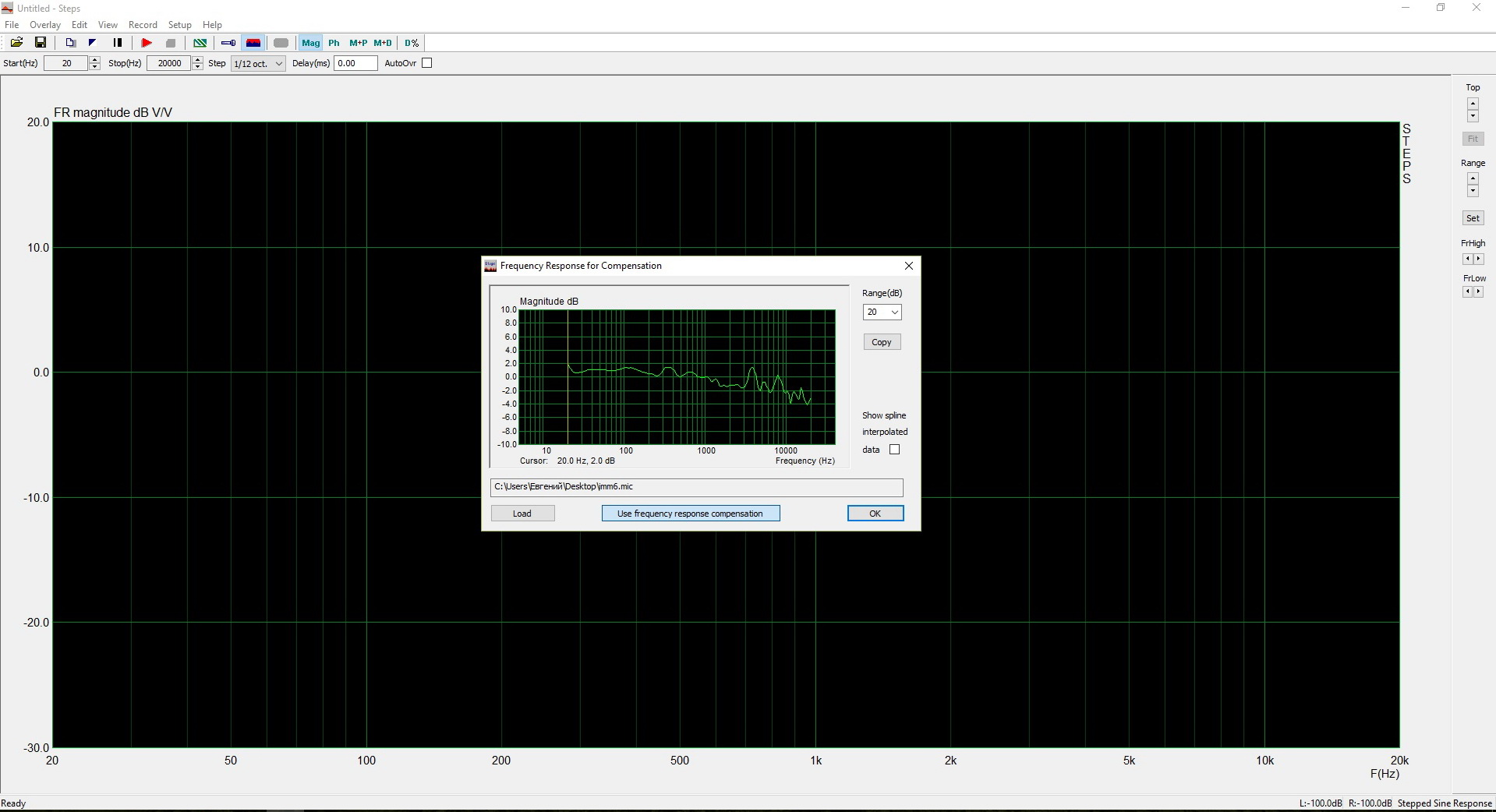

    ---------- Сообщение добавлено 18.03.2017 в 01:01 ---------- Предыдущее сообщение было 17.03.2017 в 11:58 ----------
    Ура! Импортировал таки файл в ARTA. Просто LoudspeakerLAB с каким то своим .dat файлом. На самом деле можно и туда импортировать наверное но это займёт какое то время. Может потом попарюсь. Испробовать не могу. Нужен переходник с 4х контактного джека на стерео стандартный 3х контактный. TRRS -> TRS.
    Но всё равно я не пойму как он туда импортировался и правильно ли? Так как внутренности самого файла не понятные совсем.
    Может быть такое что что то ни так? Похоже вообще что всё окей...

    Евгений, делишки не очень.
    Фирма Dayton Audio в файле коррекции не прописывает фазу. И видимо это основная причина, почему Лспилаб не хочет ( или не может) видеть этот файл.
    Лспилаб вообще то и импортировать файлы без фазы не хочет, не только коррекцию микрофона.
    Надо сказать, что Лспилаб я знаю неважно, может где то можно фазу отключить, не знаю.
    Программе Арта, в отличие от Лспилаб годится файл и без фазы.
    Что можно сделать? Можно вручную в текстовом файле прописать третий столбец-фазу. Раз нет измерений, то ровную линию, все нули. Работка еще та, если вручную, но теоретически выполнимая, долго только.
    И должно схавать и все сработать.
    Я не готов пока к такому труду, извините, сами.
    ЗЫ. Ваш файл коррекции с текстом в виде строчки у вас по причине сохранения страницы в виде .тхт
    Надо было скопировать текст на странице и вставить в новый, пустой файл. Но это мелочи.
    Вот ваш корректирующий файл, немного облагороженный для дальнейшей работы.
