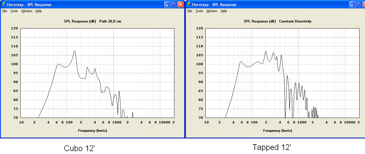

    Прикинул:
    А вот вариант Cubo 2x12* - очень даже ничего при внешнем объеме 180л
Название:	АЧХ Cubo 2x12*.GIF

    Вот вариант в Tapped 12*
    Qts = 0.211 Total Q
    Qes = 0.215 Electrical Q
    Qms = 14.640 Mechanical Q
    Fs = 41.173 Hertz, Free Air Resonance
    Res = 5.95 Ohms, DC resistance
    Ls = 6.037m H, series inductance
    Lp = 18.11m H, lossy series inductance
    Rp = 18 Ohms, loss across Lp
    Dia = 263m meters, effective
    (%shift) 16.0 %, resonance with mass
    Vas = 58.74 litres, air volume equivalent
    mms = 104.9 grams, effective mass
    cms = 141.7u m/N, compliance
    bl = 27.72 T*m, motor strength
    n0 = 1.821 %, max efficiency
    SplSens = 94.92 dBSPL max at 2.84Vrms
    (Added mass) 44.5 grams
    Xmax= 7,5 mm
    Индуктивность в зазоре B = 1.39..1.41 Тл
