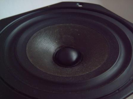

    По умолчанию Приобрел Винтажный KEF Cantor3 84 года
    Приобрел Винтажный KEF Cantor3 84 года, акустическое oформление ПИ.
    http://www.kef.com/history/1980/cantor3.asp
    Интересно узнать ваше мнение, может кто когда сталкивался, стоит над ним работать вообще?
    Cantor III Specifications
    Frequency Range 58Hz to 20kHz ± 3dB at 2m on reference axis ( -10dB at 43Hz and 30kHz)
    Directional characteristics within 2dB of response on reference axis up to 20kHz for ± 5є vertically
    up to 12kHz for ± 20є horizontally
    Maximum Output 107dB spl on programme peaks under typical listening conditions
    Characteristic Sensitivity Level 87dB spl at 1m on reference axis for pink noise input of 1W
    Distortion
    Measured at 1m on reference axis at man spl of 90dB, anechoic conditions Second harmonic:
    less than 1% from 90Hz to 20kHz
    Third harmonic: less than 1% from 40Hz to 20kHz
    Enclosure Type Mechanical reflex
    Internal Volume 17 litres
    Nominal Impedance 8 ohms
    Maximum amplifier power: normal 80W, audiophile 100W
    Minimum amplifier power: normal 10W
    Weight 6.8kg
    Weight 7.75kg (17.15lb)
    Dimensions 502 (h) x 247 (w) x 212mm (d) mm
